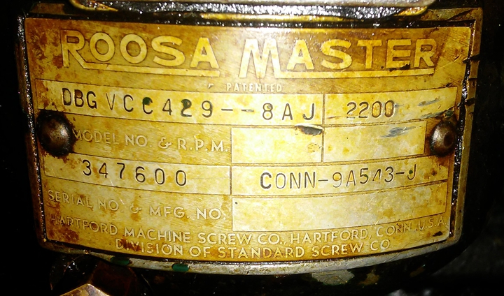

We got the 64ish 4000 backhoe dopped off today. It got dark before I could crawl over it too much but, I got a pic of the injector pump plate.
A few questions... Its wet when the engine is running, not enough to drip on the ground, but it gets wet... diesel fuel I assume. Is that relatively normal for an old diesel? Is it something that will need fixed soon, or just ignored until its an actual dripping leak? It doesn't effect it running or starting...it doesn't make any odd or expensive noises while the engine is running.
Here is the plate...

I don't know why it posted two pics... Rolling Eyes

If it is starting to weep a little on the out side the drive seals are most likely starting, or going to start leaking soon. That pump uses a back up o
ring to try and help keep the diesel out of the engine oil.Over time the o rings just get hard and leak with age. Time for a reseal. Al

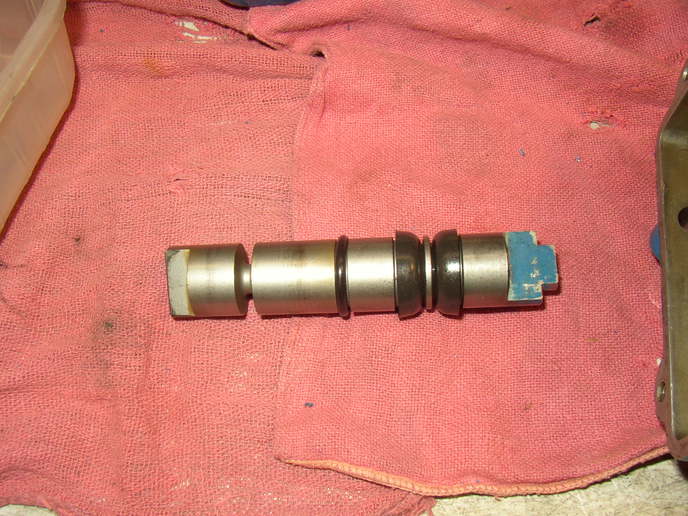

I didn't know crap about my injector pump. I pulled it apart to find my problem, and I asked everyone I could about it.No one could answer my problem. I kept working on it. Turns out to be a cam problem. All you need to do, is pull the shaft out of the pump. It should just pull by hand, some times it's a little harder to pull. It's the two rubber seals & and a o-ring holding it in. Those are the ones you need to replace to stop the leak into your oil pan.
Picture is of the shaft you need to pull out. It will only go back in in one way. Oil it up after you put the new seals on it, so that they go in the bore right. It's alot easier then it sounds. and your ready to go back on the engine.
Pat
