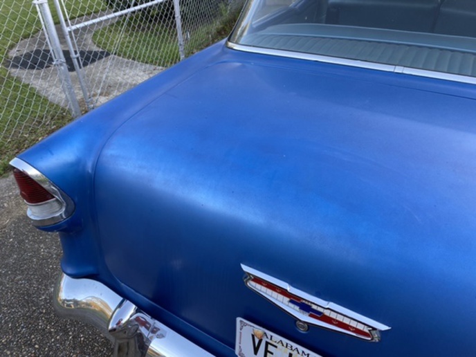

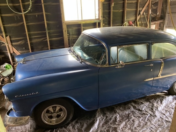

Yeah it s not an old tractor but it s old and you guys know so much I don t know anywhere else to turn....
Does anyone have any tips on cleaning the lite surface rust on the chrome? I would also love some tips on getting this paint to shine better. After looking at it up close, I m thinking nothing will really help except a better paint job......

considering what you have, i would err on the side of caution. for the chrome, in an out of the way spot , try using a chrome polish on a soft cloth and
see what happens. same with the paint, not sure from the pictures if its an old enamel or lacquer. but a little rubbing compound by hand on thenlower
fender or quarter panel.

Once rust starts coming through chrome the only real fix is to have it re-chromed. If you stay after it you can prevent it
from getting worse by keeping the chrome polished. You could use a chrome polish or you could buff it with an auto polisher
with rubbing compound. This would help the dull paint as well. The surface of paint dries out and buffing it removes this
dried out paint exposing fresher paint underneath.

Can't tell from pictures. If you really want to know, find a place perhaps under the hood you don't mind damaging the paint and put a drop of lacquer thinner on it and see if it lifts the paint or whether the
paint dissolves. If it dissolves it's lacquer. I don't see it makes a difference unless you plan to put a coat of something on it.
If you try to buff the paint and it's now working for you, you can wet sand the paint with 2000 grit paper and then buff it.

Could be a lacquer job . Try to buff it out .For chrome aluminunm foil and simichrome polish. That is a beautiful car I am envious of you . Love 55s. { all trim a stainless].

First off, beautiful '55! For your chrome, if not too pitted, use chrome polish with a soft cloth. If it is too pitted, then 0000 steel wool will nock down the corrosion, then follow-up with polish. You can even combine some polish with the steel wool. As others have said, do an obscure area first in order to evaluate your process. Your paint appears to be lacquer, but could be a type of oxidized enamel or urethane. You may address this by hand with microfiber or cotten cloths with a creamy polishing compound. You could also use a powered buffer, but take care not to "burn" through. Do not use a course or more aggressive compound. Polishing will take longer, but will be safer to your existing surface. Regardless, take care to not remove too much while polishing, as this will begin to expose the underlying substrates should the layers of color be excessively removed, causing transparency. The oxidized paint will be removed as you polish, exposing a glossy finish. If you hand-polish, the oxidized, or "dead" paint will be evident on the polishing cloth or foam buffer pad if used. Since you are unaware as to the type of paint or thickness of the color, proceed with the utmost caution. Even a professional is unable to guarantee this process because of the unknowns. Use blue masking tape (easily removed without damage) on all sharp body lines and panel edges, as those areas are more prone to rubbing through. After the major portion of the panel(s) has been polished to your satisfaction, remove the tape and follow up those areas lightly and by hand. I would do the paint first and only after a thorough wash. Then go to the chrome or stainless so as not to cause debris to contaminate the process, causing further damage (scratches). If you do rub through the color portion of your finish, the only method to restore is to repaint. If it is an original finish, then be very, very cautious to let it remain as such, for original paint is more valuable. Otherwise, if you have the ability, go to an automotive paint supplier (or call them) and explain what you are attempting to do. They will provide you more information and correct product. I would love to have that car! Best of luck to you and cherish that ride!
