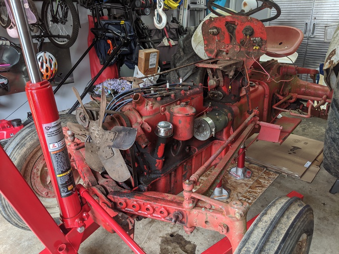

Try to support the engine and clutch housing so it pulls apart or goes together evenly.
Letting it "sag" like in the photo strains the transmission input shaft, the throwout bearing carrier, and the lined clutch disc.

The photo doesn't show the 2T engine hoist holding the motor, just like the service manual.

It doesn't matter how fancy your "rigging" equipment is, my suggestion was not to let the tractor "sag" at the split like it is clearly doing in your photo.

PostPosted: Thu Mar 26, 2020 9:14 am    Post subject: Re: Rehab of a Fordson 9N (SN 9N13647) Reply to specific post Reply with quote
Thanks for the help!!! Very Happy
