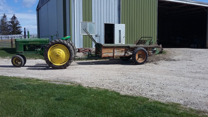

Can anyone tell what model this is by
looking at it and will it be to much
fully loaded for a 43 B john deere to
handle?
Thanks for your help!

I believe that is a 12A spreader and on hard ground it should handle it power wise. But don't load front end heavy as tractor drawbar is not strong enough for that acording to Deere. They sold a kit to remidy that and it should be listed in the John Deere tractor on line parts book.

Just realized I mispoke. That spreader is same size as the Model R Deere spreader and that drawbar support is not in tractor book but in the Deere Model R spreader parts book. They are a couple of braces from axle to drawbar that you can easily make if you see the picture of Deeres factory made ones. 95 bushel size spreader.

The New Idea 206 spreader replaced the 12A. Both are 95 bushel spreaders. The 206 has a metal panel behind the control levers; the 12A is wood. The spreader pictured is a 206.

The load depends a lot on what and how you fill it. Horse stalls with lots of straw, some wet is not too heavy. Packed and wet cow manure is very heavy. A full spreader can put a really big load on the draw bar and brakes, especially on steep hills. You control how full you load it.

pulled one like that with a Farmall 140, loaded pretty good with wet cow manure, flat ground.

I bought it. The tag says no. 17 Does anyone have info on that model like when they was made and if parts are avaliable anywhere if needed? I think it pairs good with the 43 B! Thanks

Not a spreader, but I have gotten New Idea corn picker parts at our local Agco dealer. On parts that are no longer available, many times they were able get them from Parts Depot.
