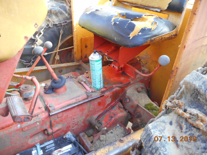

As I posted before I do not have a wiring diagram showing an alternator on a 580CK, hopefully someone has the right schematic with an alternator and will pitch in on that. When I see your pictures I'll see if I can figure out what needs to change for the schematic I have to work with your alternator. I don't want to give you something that will mix you up more.
I will also see if I can identify the switch you are asking about. While you are trying to get your pictures to post, Is it the same as this switch, with green wires going to it, by the shifter on this 480? If you are taking pictures with your phone the files may be too large and you need to reduce the size.

Yes that?s it with green wires mine has a red wires ,I?ll try send
pics again

That is the Neutral Safety Start switch which (I told you by the schematic) should have a yellow wire coming from the start terminal of the ignition switch hooked to one of its terminals and another yellow wire going from its second terminal to the S terminal on the starter solenoid.
Again you know the wiring may not all be original so you cannot get hung up on colors, you need to chase out the wires you have and see what they run between, just like these two. If someone has taped a bunch of wires together to make a harness you may need to cut the tape so you can follow the wires. You may find they spliced a different color on the end of a wire and the color further back matches the schematic and is correct at the second termination point.
Also, does your tractor have an ammeter or just the charging indicator light?
