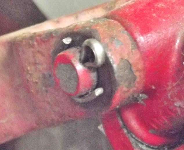

Then how about this?
These are the stainless cotters on my upper arms and when wrapped around the pin , the cotter serves as its own washer.
Also shirt sleeves and finders don't get caught or cut by the ends of the cotter pins. I know cause it has happened more than once. :)

All right...all right, I give up. Putting the lynch pin in the big hole prevents that pin from ever sliding out so...problem solved.

Assuming the cotter pin in the same spot on the other side is the same age, maybe the pin that rusted away missed the plating process?
If they are virtually never removed, why have a roll pin on one side and a cotter on the bother side anyways?

I guess the makers assumed that it would be easier for the purchaser to just slide the large pin in and stick the supplied cotter pin in there instead of having to drive in a roll pin.

Earlier today before I ever saw your competitive response; i.e., "All right all right, I give up", as though I'm being forceful or underestimating you . . . I thought to myself . . .
I doubt very much I will ever hear even a fragment of a response like, "A stainless pin, that's an idea" or whatever . . . any positive acknowledgement at all and sure enough you didn't disappoint.

I will pick up some stainless but I am not gonna wind them around just to make it purity...

The real reason I wrapped them around was cause I drew blood on one of them while I was replacing my leveler box.. :wink:

On a tractor 1/8 and smaller yes wind them up 3/16 are more they hold enoufh spring tension no need to...

OK, I apologize if you think I sounded that way. You kept talking about putting a washer in there. But, I thought I told you there was no place to put a washer way before this. That's why I bothered to take the last picture, to prove there was no place for a washer. Sorry you took it badly.
Stainless steel cotter pins are a good idea and I think I'll pick up some next time I go to town. The new pins I used after the rusted ones are from one of those Harbor Freight boxes with all assorted size cotter pins. But, I'm sure they are not stainless.
I could actually go nuts and drill out those holes in the large pin to accept a roll like is used on the other side. But I reckon the large pins are hardened and why bother to do all that, as I said putting the lynch pin in the large hole along with the cotter pin assures me that the large pin is not going to attempt an escape again. Again...my apologies.

I can see where the washer thing doesn't really apply here like it does with the movement of small control rod linkage and cotters.
When I posted that pic of my stainless cotters I was thinking that you could see I didn't use washers myself . . . but I was speculatin' about what might have happened to your cotter pin like maybe it had been sheered off.

Thank you. It's still a mystery but since I saw the condition of the other remaining pin I still have to go with rust as the culprit. But even if the legs rusted off, how did the pin work itself "up" out of the hole? Still gonna' get those stainless cotter pins.

So I'm thinking . . . maybe all that side to side sway
is causing the Fast Hitch casting to be tapping the cotter pin over a long while, eventually sheering a rusty one off at the edges of the big pin hole.
Hobo saw the curls as only pretty
but when you bend that hard stainless around
it can actually act as a shock absorber sharing the pressure on working part of the cotter pin where it goes through the big pin and gets beat against the Fast Hitch hub. That's what I meant before when I said that this hard stainless cotter pin can be it's own stress dissipating washer, if you curl the long ends around -- and even bent those curls toward the hub.
Once those cotter pins are in do you just leave them in?

If you had Pats you would understand they can easily be removed and installed and you can go back to the conventional system if needed... I am sure my Pats have a better fit than an N because my lift arms are thicker...

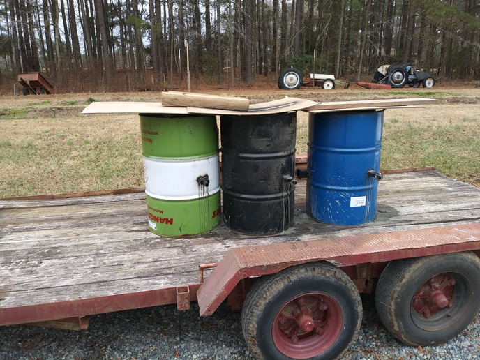

I keep a 1000 lb. counter weight on my bota most all the time so they get a damm good test every time I use it : )
This one was made for another tractor with cat 2 pins that's why they are riding high in the pats U it was a test only pix....
The blue barrel is mine...
