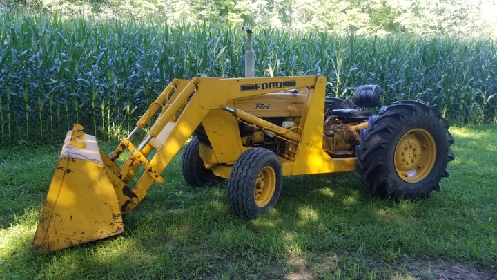

Hello all, new to the forum. I recently purchased a Ford industrial tractor and was told by the seller that it's a 1987 545A. I started doing some research and now believe I may have either a 340 or 340B. It has a 3 cylinder gas engine and 3 forward/2 reverse trans with hi/lo range. I'll post some pics, one of them being the ID label on the underside of the hood. Any help would be greatly appreciated.[/img:50d52fd861]

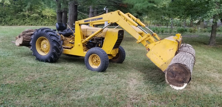

PostPosted: Wed May 19, 2021 6:43 am    Post subject: Re: Help identifying tractor Reply to specific post Reply with quote
Back to top
View user's profile
BlueLB7
New User
Joined: 08 Aug 2020
Posts: 11
Report to Moderator
PostPosted: Wed May 19, 2021 6:44 am    Post subject: Re: Help identifying tractor Reply to specific post Reply with quote
Back to top
