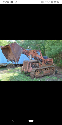

Can I get some help iding this dozer. I'm interested in purchasing it but the tag is missing from the dash. My best guess is mid to late 50s D9? Any help with identifying this and any restoration parts website would be a great help.

It's an international harvester, from what I have found of pictures it looks to be a TD9 with a drott loader.

Lots of difference in a D9 cat and TD 9 ih. The drott loader on an old td 9 was tough to get down in
Start by telling us if it is a 4 cylinder or 6 cylinder that will help narrow it down. .Something
that old can be a real money pit.

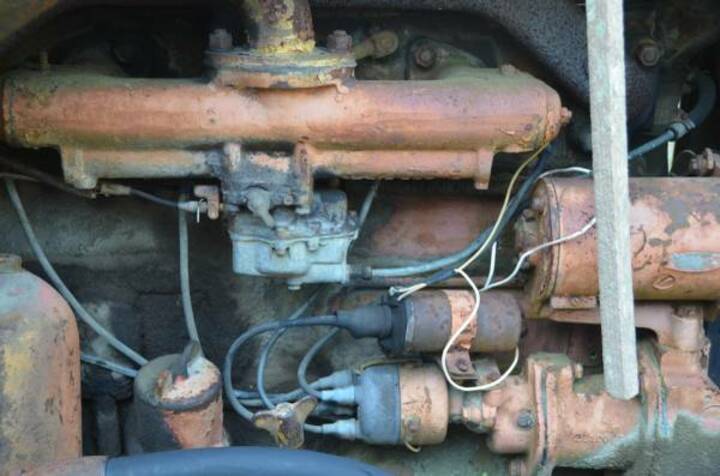

Sorry the original post was a typo of D9, it should have read TD9. It is a 4-cylinder gasoline and diesel engine. It does not have the pony motor that has gas but actual spark plugs in the same block and head as the diesel engine.
The tins all say International Harvester on it so I have no doubt that that's what it is as far as manufacturer, my question more is motor size and years of that I can try to source and price out parts. The Dozer has been sitting for 2 years and I was able to get it cranked over tonight but did not want to start messing with the gasoline engine portion without having a deal completed with the seller. I did not want to do the work or somebody else if I was not going to be able to close out a deal or Source parts

Int td9--built 1939 to 1962---59800 built
weight--9800 to 10800 without attachments
serial #---lower left dash
334.5 CI----1400 rpm

Is there any other locations for the serial number, someone has removed the tag. Or is there a stamped casting number anywhere, the tag on the starter, and loader arm are unreadable.

More Picutes

The picture is TD9 International he is smaller than the D9 CATERPILLAR and am still have some
