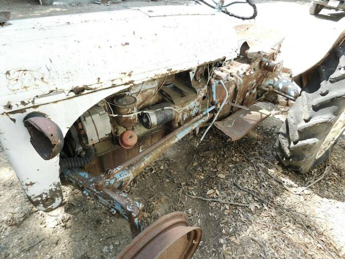

Posted: Sun Sep 27, 2020 1:02 am Post subject: Broken Hi/Low Sherman Lever |
When an arm breaks does it typically break down inside? Saw this one online that appears the Sherman was removed.

Posted: Sun Sep 27, 2020 5:32 am Post subject: Re: Broken Hi/Low Sherman Lever |
Sherman was removed and hole was not plugged. |

Posted: Sun Sep 27, 2020 8:39 am Post subject: Re: Broken Hi/Low Sherman Lever |
Ill bet you the sherman is in there.
The handle came off.
If someone split the tractor to get the sherman,
They probably would not put it back together!
Joe |

Posted: Tue Sep 29, 2020 1:41 am Post subject: Re: Broken Hi/Low Sherman Lever |
The hole was for a sherman combo. Some times a handle can come loose and can come off but unlikely. It could have be taken off. Typically they don't break inside and you should see
the square for the handle close to the end of the hole. If you don't see that it's likely, as Mike said, it was replaced with input shaft and not patched.

Posted: Tue Sep 29, 2020 11:23 am Post subject: Re: Broken Hi/Low Sherman Lever |
If you are close enough go check it out smooth hub
in backround. could be a money maker for you |
