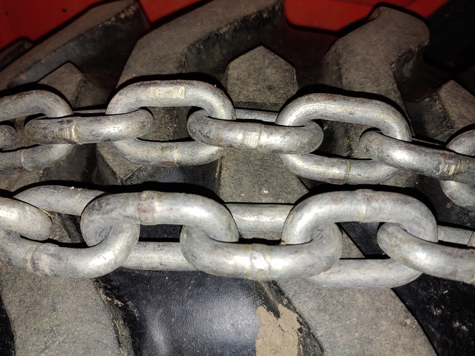

heard today pa dot checked a man with trailer and told him his chains werent dot compliant they didnt have dot tags on
them is this true? never heard of this

I'm not aware of any DOT tags on chains. Here's a quick reference. https://www.columbusmckinnon.com/en-us/resources/blog/the-low-down-on-chain-tie-downs/ But I use straps for hauling wall block, and pavers, and they do require tags.

Sure, Chains are marked(stamped) if they are not tagged or stamped, then they revert back to common capacity. Gold colored chain is coded as grade 70(transport chain) I like 5/16 grade 70.easy to throw and easy to get around axles and draw bars. I also keep a set of 3/6 for the heavy stuff.

Some chains actually have a metal . Most have a g70 stamp and gold colored if they grade 70 which is what they call transport chain : you could get some g120 chain which is blue if you want to really tie something on

Graded transport chains are stamped into every few links.

Karl in PA, YT is the best place that you con go to to get false information on transportation laws. You will get a lot of "I was always taught", and "A DOT inspector told me" or "I was always told". For the correct information read it yourself at Cargo Securement rules FMCSA.
