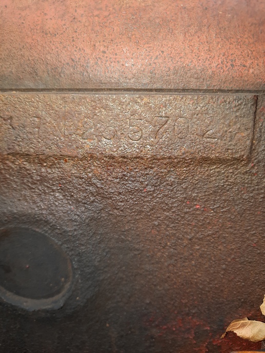

Hello, I am trying to restore my ford tractor. I got it thinking it
was a 9n, but now I not so sure. I still think it is a 9n but the
vin number is kinda weird. I resently got a 2n tractor for parts,
I know that is a 2n. The vin on the 9n indicates it was made
after the 2n. Which I thought was weird because the 2n was
made after the 9n. The 9n also has all the 9n parts if it was a
2n. Also the vin on the 9n has diamonds instead of stars but
still says 9n. I have heard the diamonds were on only the 8n.
Does anyone know what ford tractor this is?

Serial number would make it a '44. Likely rebuilt sleeve changed out to heavier ones. Numbers were restamped. Ford didn't use that 1 or 6 They used an I and b.

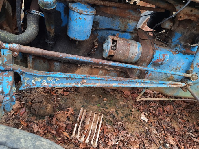

Both are 2N. I just sold 9N #90063 one of the last 9Ns before the 2N transition. Nice to see a 6v generator instead of the goofy 12 volt alternators. Keep us posted. Thanks.

Just noticed what looks to be a cyclone underhood air cleaner, if it has the original jar and bail, those don't show up often. Another cherry on the pie.

Thanks for the feedback. If it is a 2n like you guys say I don’t see why someone would change everything to 9n parts.

All 2Ns had 9N as serial no. prefix. Tubular radius rod rather than forging says late "44 to "47 2N .Mine is an early "44.Been riding it since I was two and it was just a baby...................GTM

BINGO!!
Blue one is a 43
Red one is a 46
Not to many changes along the way. bolsters,radius rods etc were probably the most noticeable.
The later ones had the dreaded 2 pc bolster, the red one that is on my enemy list, for personal reasons.
I THINK all had the curved left brake pedal.
Correct me if I'm wrong, I'm still a greenhorn.

The 2n that I have is all original. If the “9n” is actually a 2n
than it would have 9n parts.

Could the vin have been changed in doing this?

Again with serial numbers? OK, ALL 9N & 2N models used the "9N" prefix in the s/n. Period. Except for Industrial Models and the Moto-Tug, they all used the same procedure, with a star symbol before and after the s/n. FORD system was used on ALL vehicles, not just tractors. The 9N after s/n 12500 and the 2N were basically the same ---- 3-speed; draft control only; 1-wire/3 brush gen and round cutout; 1-wire starter w/ no solenoid; and a few steering box changes. In your first photo, someone falsified that number. The numerals '1', '6', and '9' were letters and the other numerals aren't the same font either. Someone added a fake diamond symbol as well. Means nothing s well. You'd want to inspect the cylinder bores to tell but know that steel liners are no longer made today so it's a moot point.
Again I say, serial numbers mean nothing really, unless you have an early 9N or early 8N you are restoring. FORD serial number stamps used from 1931 to 1950, not just tractors, all vehicles, used the STAR (*) symbol before and after the s/n to designate that STEEL CYINDER LINERS were used. In April, 1950, FORD revised to cast iron sleeves, changed the star to a diamond (<>)symbol and that is what is used/sold today -they don't make steel ones anymore, and were not good to begin with. That is probably why they had to mark the blocks as they anticipating making a change at some point. Just because your s/n has the star symbol don't assume it still has steel liners. Chances are the engine has been rebuilt at least once and very possibly could have cast iron sleeves now. You wouldn't know until you stripped down the block. If so, cylinder bores could also have been bored out larger so that is why I always say never to buy an engine kit until you have all the parts out to see what you need. Again I say, s/n's are a moot point. The important things to know are: 3-spd; DRAFT control system; front mount distributor, steering box changes; and if it has been switched out from the OEM 6V/POS GRN system to a 12V/NEG GRN system. Your essential parts books are a valuable tool.

The air cleaner "red one" in your photo is the one I like.
