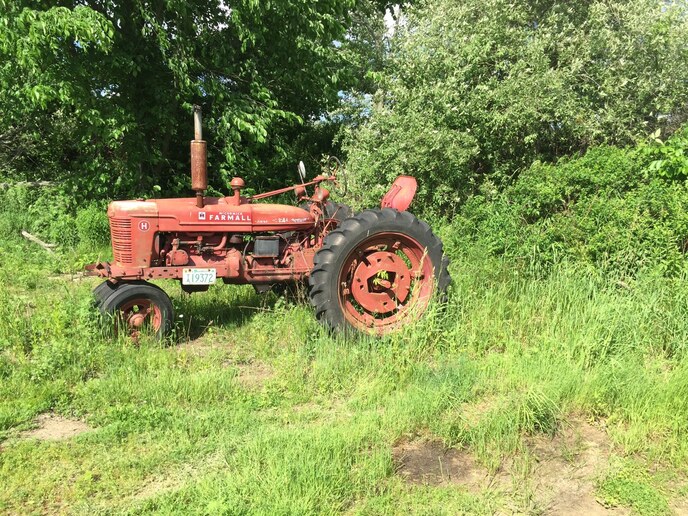

Be sure it is Acrylic enamel and not Alkyd, or, if you want to be able to have it out in the sun use 2K urethane. Here is my friend's H which the FFA repainted for him a few years ago. It stays out doors. You can see that where the paint was protected by the decals it has held up pretty well.
