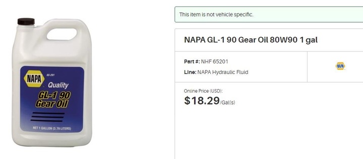

The parts guys here are mystified when I ask for 90W GL-1. They want to sell me the Universal Tractor Fluid that meets GL-1 spec yet its viscosity seems like water compared to 90W gear oil. I'm in BC Canada so does someone here know what I can ask Napa for? 50W engine oil is something else I can use which may be easier to order in. Link above recommends 90W GL-1 or 50W motor oil

PostPosted: Sat Jan 16, 2021 2:59 pm    Post subject: Re: T223 transfer case oil capacity?? Reply to specific post Reply with quote
This look right to you?
