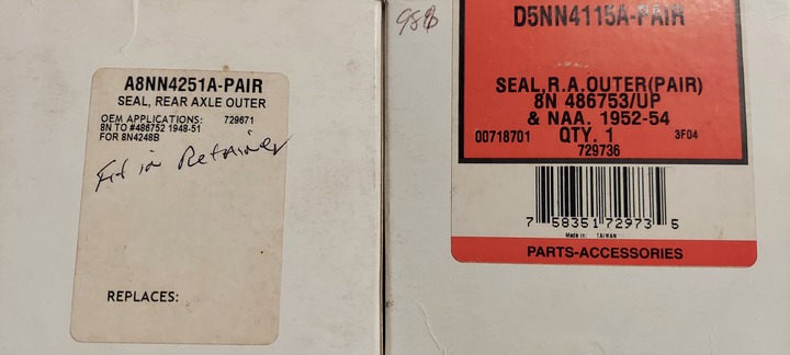

Trying to get the parts I need ordered for a brake job, and while Im there, figured I replace axle seals
also. Having troubles deciphering the parts sites to make sure I get all the right seals, and dont miss
any.
Its a 52.
Does anyone have a list of all the seals I might need to knock this out when I get it to the shop?

The outer grease seal for either 48 to 51 are 51 up up are basically the same... Either will work. Whodathunk it...
The first design is a double lip the second a Sigle lip that's the only difference... I use the old retainer and replace the seals.
Either will work.

late N inner seals 8N4233A-PAIR
Axle gaskets I would get 10 # 9N43130
Years:1948-54 Gasket, Outer Axle gasket 8N4225 ( I don't use them I use good RTV)
Years:1948-52 Gasket (Rear Axle Oil Seal) 8n4290 (I don't use them I use good RTV)
