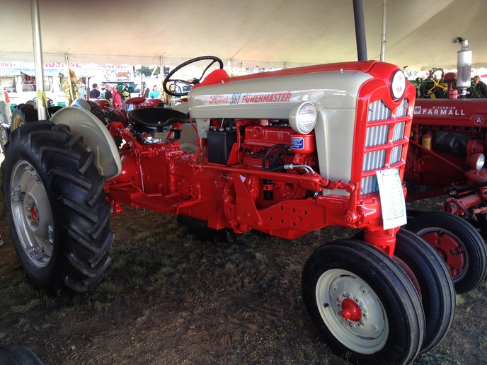

I cleaned mine on a wire wheel, stuck them in holes in boxes and primed and painted as I was doing the the rest. Where they were noticeable I touched them up a little afterwards. I hate the look of the new bolts.

Showcrop.your tractor looks great!
