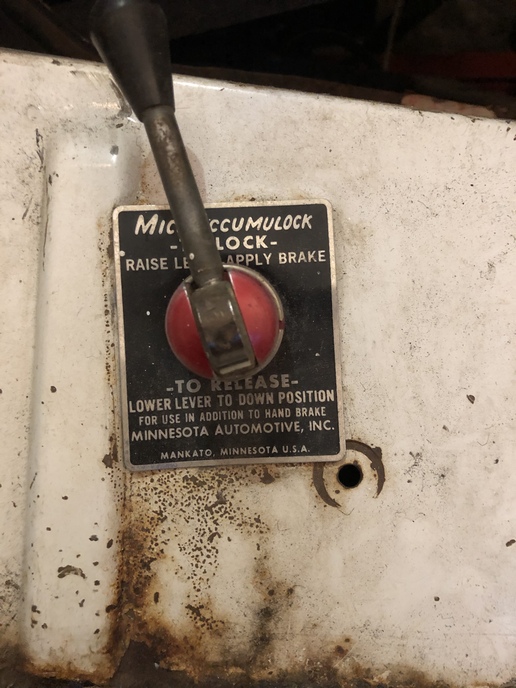

So the nightmare continues... we are still trying to bleed the hydraulic beakes on this 77 International Loadstar 1700. I adjusted all the brake shoes so drums dragging and after 3 hours of brake bleeding pedal still goes to floor on first push. Master cylinder replaced and new slave cylinder\booster set up
Replaced. Everything thing bled several times over and over. Then I notice this mico accumulator beside\under drivers seat which is inline between slave cylinder and junction tee for lines to front and rear brakes. Could there be air trapped in this?? Should I just by pass it or is it needed to pass vehicle inspection? None of the 8 wheel cylinders are leaking yet I cant get the brake pedal to just stop where its supposed to. After truck sits for a minute the brake pedal goes to floor on first push, then slightly more than 1/2 way down on 2nd push and then 1/2 way down on 3rd to 20th push. Ive researched buying a pressure bleeder yet there seems to be conflicting reviews theybwork and they are all prone to leaking. Any suggestions? Correct way to bleed madter cylinder?

As for that Mico lock. We had those on few older vehicles when i first went to work at UPS. I was instructed to remove any I found as they could bleed pressure off over time and the truck could roll away.....Ed

Hi Ed. Thank you for your reply. Much appreciated. We are planning to bypass mico accumulock especially now based on what you said. The old m-cyl was going to floor on first gentle push and then build up like you describe. I put in a new m-cyl in and same pedal behaviour so I am leaning towards trapped air in mico accumulock or one of brake lines possibly to a wheel. In the yard in front of shop I am going to see if one of the wheels are not braking. Then Ill put truck in shop and take mico accumulock out of system and then try to bleed brakes once again. I put in a brand new slavebooster in past weeks.

It still seems to me that you still have excessive travel at the wheels, or a huge air bubble. I dont think there is anything wrong with either master cylinder, they are pumping up exactly as they are supposed to. Start by bypassing that line lock. Then using two people, bleed the right rear wheel by holding your finger lightly over the open bleeder while an assistant pumps the brakes hard. There may be an air bubble in the line where it humps over the differential, though Ive never had that be a problem. The larger the line, the more velocity it takes to blow air downhill. The bleeder should be wide open. You can put some silicone grease or Teflon tape on the threads if youre concerned about sucking air between strokes. If this fails, make a plug by brazing shut an inverted flare nut, so you can plug the tee where the lines go to the front and rear of the truck, thus isolating half of the system so you can see which end is giving you trouble. If you have changed any brake lines, they cant have a bunch of humps in them. Some people dont own a double flaring tool and buy pre fab lines at the auto parts store. They are never the perfect length, so the excess is stuffed wherever it can go. Using 1/4 tubing, youll never get the air out unless the fluid is coming out of the bleeder like a fire hose.
