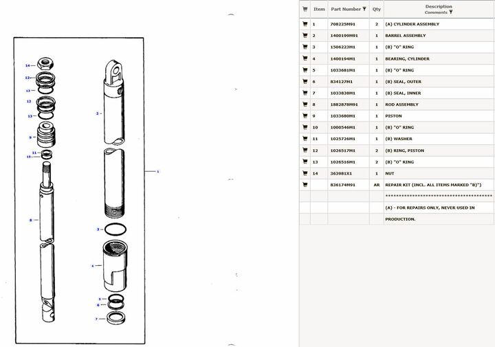

I have the Cessna lift cylinders 708225M91 I ordered kit 704654M91 but its a bit different.
My plunger has an O-ring with, looks like a Teflon seal over the top and also has a phenolic ring 3/8 wide looks to ride on that.
All I have in the kit is O-rings and nothing the size or width to work.
The end cap has a packing inside, the kit does have an o-ring that looks to work for that and also an outside seal.
Thanks

I did find a high speed piston seal from McMaster-Carr 1526N18 that will fit perfect just need to cut the groove a bit deeper. This is really all I was missing, the phenolic ring measures ok and will work.
Craig

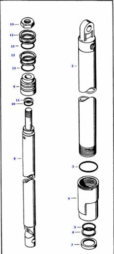

Wow, that pic got compressed and unreadable. Let's try this:
