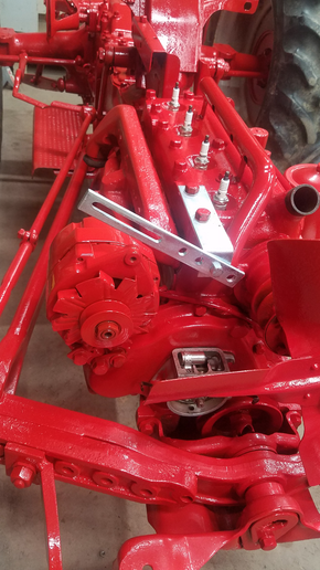

Got my first batch of parts today... put the alt brakets, pulley and belt on... 99% sure I'm gonna paint it... it sits much closer to the engine now... much better

PostPosted: Mon May 03, 2021 10:00 pm    Post subject: Re: Paint the alternator? Reply to specific post Reply with quote
Decision made...

PostPosted: Tue May 04, 2021 2:52 am    Post subject: Re: Paint the alternator? Reply to specific post Reply with quote
Smokeonthewater wrote:
(quoted from post at 23:00:01 05/03/21) Decision made...
I like it!

PostPosted: Tue May 04, 2021 9:42 am    Post subject: Re: Paint the alternator? Reply to specific post Reply with quote
Thanks bud... can't wait to get it all done... gonna break my heart to sell it.... I suspect there will be another one in my future one day that I'll keep tho
