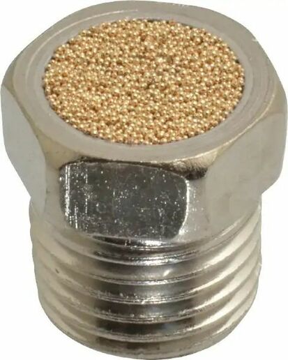

These can be used also. $2 at MSC

Have you ever used these ? Looks like you must drill and tap. Is there enough metal their to tap without leaking ? Thanks

MSC ? (old guy )

I wouldn't take a chance on ruining the carburetor. They are getting harder to find and way to expensive. The correct part isn't that expensive and if you have a Deere dealer close by you can have it in a couple days. Online will probably be a week or two.
