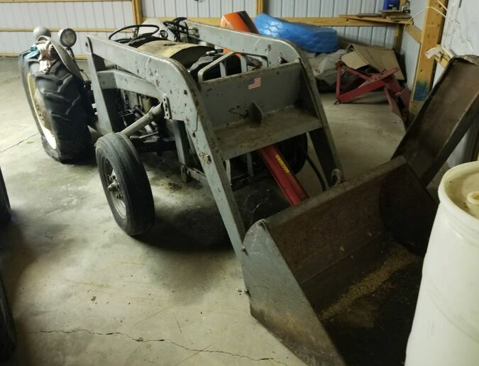

PostPosted: Tue May 04, 2021 3:39 am    Post subject: Re: TO20 12V or 6V? Reply to specific post Reply with quote
Looks like an alternator to me. Thank you!
Here are some pictures I took awhile back.

PostPosted: Tue May 04, 2021 8:23 am    Post subject: Re: TO20 12V or 6V? Reply to specific post Reply with quote
When I put an alternator on my TO-20 I used a 6-volt regulator and kept everything 6 volt. To prevent someone putting a 12 volt battery in, I labeled the alternator, regulator and battery cables. I had an 8N Ford someone had converted and it was 12 volt positive ground, so that is a possibility too. If you're just going to jump it, 12 volts won't hurt anything if you don't run it too long.

PostPosted: Tue May 04, 2021 8:45 am    Post subject: Re: TO20 12V or 6V? Reply to specific post Reply with quote
If it has an alternator and a 12 volt battery then it is a 12 volt. However, if it hasn't run in a long time, you might consider just winching it onto your trailer with a come along or chain hoist and then mess with it when you get it home.
