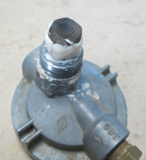

Just a little story about my BN that I was having a problem with loss of power to the point it would quit running for a few seconds then pick up and run again.
This happened a couple times last year and I found the problem to be some small bits of tank sealer that had fallen off and were getting caught in the inlet to the fuel strainer/shut off valve. At that time I managed to pick out the few pieces that appeared to be some small drips that did not adhere to the take when I used the sealer. It ran great the rest of last year and then last week it did it again.
The fuel strainer has a cast in "standpipe" about 7/16 od with a 1/4 inch hole in the center. This time I was able to see with a flash light a nice round flake of this sealer maybe 3/8 round just managing to seal off the top of this "standpipe". As there is no perfect way to be sure I would ever be sure there were no more of these little flecks hidden in the tank I decided to try something to make it impossible for them to cause a problem in the future.
What I came up with is a screen to cover the top of the "standpipe" so there is no nice flat surface for anything to create a seal on top of it. What I used was a piece of screen from a water hose washer with a screen made into it. formed it to a nice fit on the "standpipe" then epoxied it in place. See picture below:

This should also be a cautionary tale about using tank sealer. Seems more often than not it ends up flaking off and causing more problems than it solves.
If you've got some good stuff that works for you, hey, knock yourself out.

Well as the only option I could see was to try and find a "new" tank and hope that it did not start leaking a short time after installing it.
I think the biggest problem with using the sealer, at least the one I used, is getting the tank clean inside. This can be a problem with the internal baffles, can't really see some areas of the inside to know if every point was nice and clean.

I like your solution! Looks like it should work well and won't cost a fortune.

your other chose would be to drill out the stand pipe portion and purchase a longer stand pipe. I have seen them listed [ I think at Stiener]
and replace the short original one on the sediment bowel inlet. This would also clear the problem since the inlet would have more surface to
draw in fuel.

Well all this cost was time. Scrounged around and found the piece of screen and had an almost empty tube of marine grade epoxy sitting on shelf.

(quoted from post at 14:18:11 05/06/21) your other chose would be to drill out the stand pipe portion and purchase a longer stand pipe. I have seen them listed [ I think at Stiener]
draw in fuel.
Actually that was one of the considerations I was thinking about. One idea was to just take a inch or so length of 1/4 in O.D. tubing and drill a bunch of small holes in it and epoxy that into the inlet to the sediment bowl.
While scrounging around I came across this small piece of screen and then used the holes in my drill index as a form to neck it down to a nice fit on the inlet tube. Then slipped it in to place and used a small worm gear hose clamp to crimp it down good and tight.
Then as one more idea I slipped it off and used a 1/2 bolt die to cut some shallow threads in the cast stand pipe to give the epoxy a little extra grip on the stand pipe.

Some people have adapted the gas tank screen from a Model A.
http://farmallcub.com/phpBB2/viewtopic.php?f=11&t=45914
