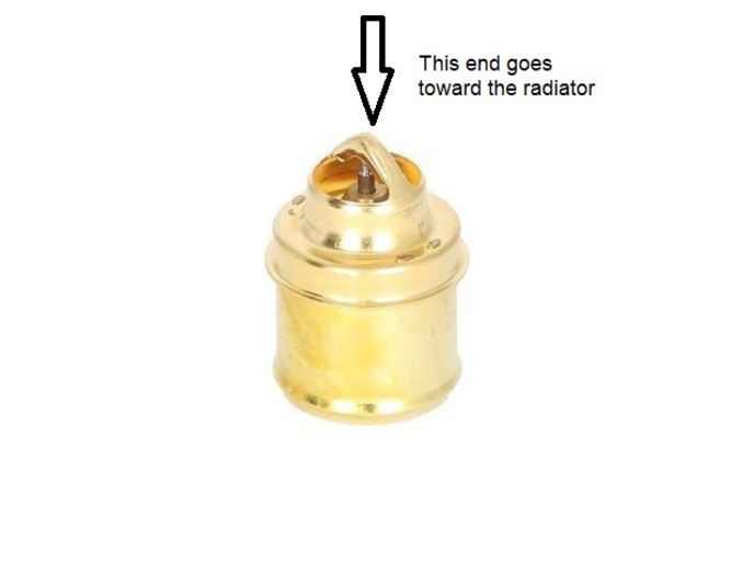

TO 20 i have two Neither one has a thermostat. One runs mid range temp other hot will run in the red at high RPM , switched temp gages to check thats not it. I have a new thermostat . Question? Goes in the top hose "yes ??" Pointed end into the flow "yes??" THANKS

(quoted from post at 11:46:26 05/06/21) TO 20 i have two Neither one has a thermostat. One runs mid range temp other hot will run in the red at high RPM , switched temp gages to check thats not it. I have a new thermostat . Question? Goes in the top hose "yes ??" Pointed end into the flow "yes??" THANKS
Pointed end goes towards the radiator, the end with the copper/brass colored bulb goes toward the engine. That bulb senses the coolant temperature and opens the thermostat.
