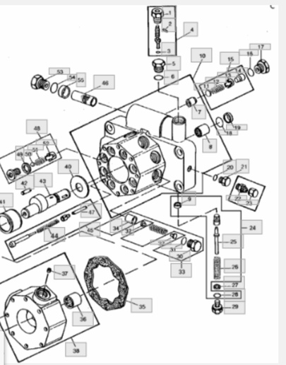

You need to check trans pump GPM output which should be 4-5 GPM. Another possibility is faulty stroke control valve in frt hyd pump.
Closed hyd repair requires ""very good diagnostic procedures"'.

It is past time look into the stroke control valve in the front pump as Tx Jim and Tech 7 have suggested .
There could be something in there taking the pump out of stroke . There is a little bitty screen in there that is worth taking a look at .
Speaking of which . When in there this would be the time to install the manual de-stroker . When turned in it stops the pump from operating and reduces the load on the starter .

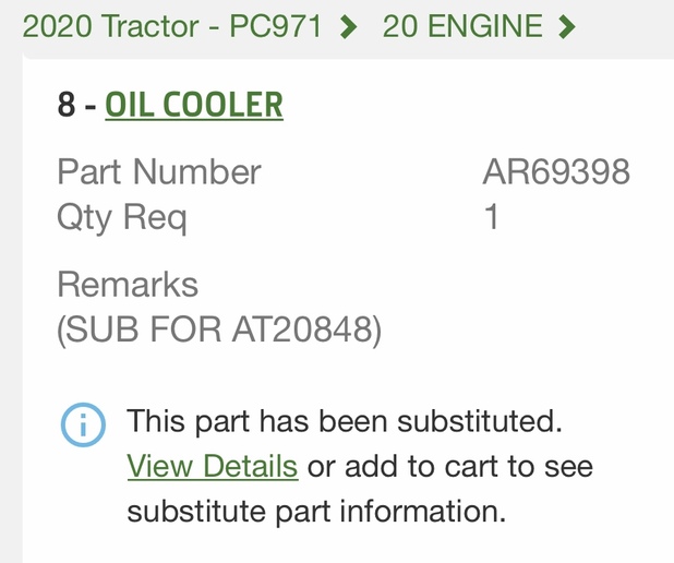

Is there flow through the power steering column even when the steering wheel is not being turned ?
Is the oil cooler plugged with 54 years worth of oily mud ?
While the front end was all apart on my 1640 with rad and oil cooler in plain view . I was dismayed at how plugged and filthy the rad and oil cooler still were . Even through I had previously hosed them out with a hot water hose connected to the shops domestic water heater . A high pressure washer will ruin the cooling fins .
Cleaning with straight on unobstructed access was required to clean the cores and fins .
