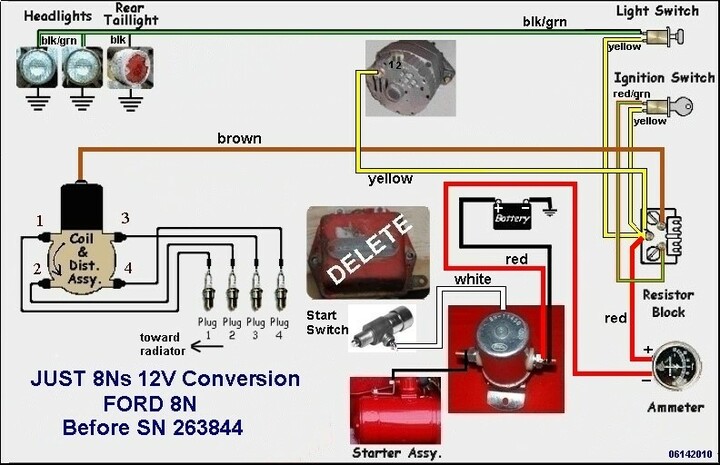

Is this tractor new to you? You mentioned new plugs and wires but what about the points and condenser? Have you checked the timing? Does it have a ballast resistor or a ( 12v no external resistor needed) coil? Coil resistance should be around 1 1/2 ohms with a resistor and 3 without. Valve lash? Vacuum loss? (Spray brake cleaner around carb and manifold and listen for speed change). Breather clean?

K. Larues' diagrams are good but I find JMOR's easier to read.
He has many, so if this isn't the one you need, Google them.
I understand and appreciate the sentimental value.
The fact that it was set up makes me want to double down on the compression check.

I am waiting for a compression kit to arrive, I did skip over and confirm the wiring diagram, I did not get to test the resistor as my grandfather needed help.
So while there I checking the wiring, I grabbed a test light to verify power to the coil/dist and the damn thing fired up. Keep in mind, the last time it ran was when I initially posted, and the fuel is turned off. I guess I should let it run until it is empty.
