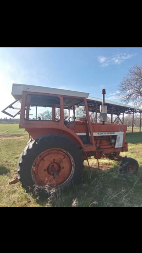

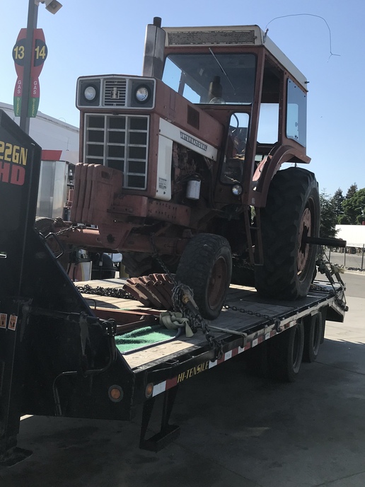

Here she is!

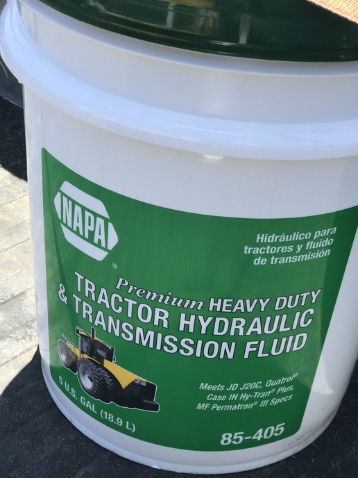

Is this hydraulic oil good enough?

Disclaimer, all my tractor projects are approached with extreme frugality in mind, you might even label me as a ..tight
arse. As I said I would leave the filters that are on it but n place. Now if I thought I needed to put a new filter on it to see if
it would even run I personally would use a $10 filter instead of a $25 one. I am sure your local NAPA could get you the
filter you need. Also in my opinion that oil is fine to get it running and see if it will move, because you will likely want to
drain and refill the hydro and rear end with new oil if it proves to be useable. Why trash a $100 bucket of oil if a $50 one
will do? I have no idea what the actual comparative prices are. And in this case with hydro I would agree with using what
barnyard recommended. I will attach some info about the batteries for your tractor. If you want additional info on them
search for ..IH 1066 batteries.. they are the same thing. If you try the same with Hydro 100 you get squat.

What I meant to say was after the drain out, the fluid to put in it for long term use is the hydraulic fluid recommended by barnyard. ...oh to have a forum that allows you to edit a post..

Update: tractor runs beautifully and smooth. I did find diesel fuel in the oil belly pan oddly. No water in any plugs. Hydro trans pulled through the brakes. Steers good. Has a mild front water leak. I only gave $2500 for her. Thank you all for the comments. Ended up being 2 12 volt 3et batteries.
