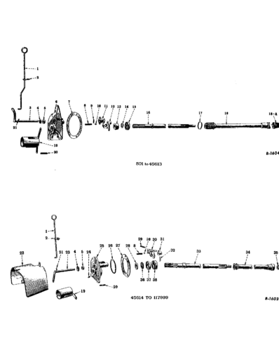

I took a quick look at the parts diagram on the CaseIH website, and it shows two different "old" style PTOs, one that appears to have a washer, and one that does not. You have to go by the pictures because the website only lists the parts you can get from CaseIH in the callout. Any NLA parts are not listed so you don't try to order them, or insist to the parts guy that he HAS to be able to get them, he just HAS to...
Serial 501-45613 looks to use a thrust washer (Part 17 in the diagram)
Serial 45614-117999 do not appear to need that thrust washer.

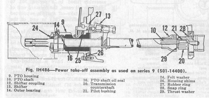

I have this diagram only. Labelled "series 9." Looks similar to my H mechanism, except my Zerk at at the bottom. It shows the washer (No. 29).

Barnyard: Got it. I was looking in the "CHASSIS" section, and it only showed the blank flange. I didn't think to look in the "19-Attachments" and "226-Attachments-Power Take-off, Special."
Looks like I get to go fishing. Hopefully it's back between the bull gears so I can reach it from the PTO opening.

Looking at it again, it looks like THIS is the thrust washer (indicated by pencil in picture)? If so, then I've already got it! It is a tight fit on the end of the PTO output shaft, so it didn't drop off. Thanks, Dave

Yes if one washer is on there that's it. Later model PTO will bolt on to that tractor without changing the counter shaft if wanted or have trouble finding parts.

Thanks. I am not sure either CaseIH parts diagram is 100% correct--mine has the O-ring, not the gasket as shown in my IH486 diagram.
The washer is on there tight, and almost seemed like it was a machined part of the shaft. Ken's washer just dropped in place in the video. But the splines would have been hard to cut on the original shaft if it is not a separate part. Glad to read I don't have to fish for it.
