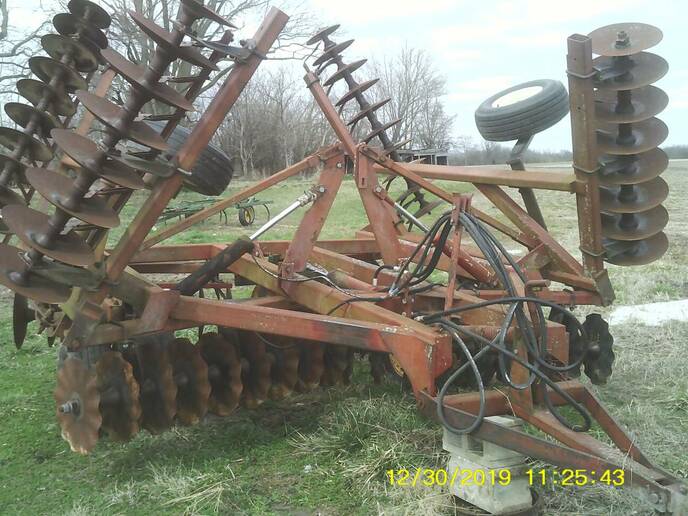

Is there any disadvantage to buying a bigger disk than I need, because it's cheaper, with the plan to remove the extra blades to make it less wide?
I found an International 490 disk that is 22 feet wide for $1,500. I've heard that the 480 and 490 are the best of the older disks, so that's what I've been looking for. I think the 490 is better, because it's heavier, I think this one has good blades.
I have a 986 and have been looking for a 16 foot or 18 foot disk.
I'm thinking, since this is a good price, that I should buy this tooooo wide disk and remove the extra blades to make it about 18 foot. To do this, I would have to take off each wing, looks like it's held on by 3 brackets. I think I can remove the end bolt, remove some blades and the spacers, then put the spacers back on.
Yes, that's a project, to take off all those blades, but I think I would have a better disk at a great price when I'm done. It might look kinda funny, missing those blades, but I don't care about that.
Can you think of anything bad about this idea?
Do you have any reason that I shouldn't do this?

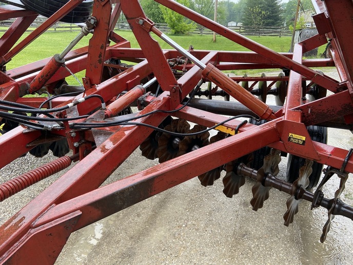

Is that the actual disk? It looks like a 24 foot to me, and the front gang has been modified into a vertical till type of tool.
Ive heard of removing the wings and just using the main section for a disk.
If you mean still removing blades from the main as well, Id think about that some. Not sure Id be happy with that.

My 490 disk (I just went out with a flashlight) is a 24 foot model, and has 9 blades on a side on the main frame, and 8 blades on each wing. That looks to be what you have in the picture.
If I wanted a disk I would not want those funny blades on it. Likely why it is so cheap. And that is a good price for a 490!
So, if you dont mind the work, you could take the wings off and swap,out the wing blades for those goofy ones, and make yourself a nice disk. That is a lot of work tho.
Looking at mine, I guess I could see leaving one blade off per gang. Any more than that and the disk wont cover its own wheels, and you couldnt work near a fence and such. If you remove blades, you need to find some stout washers to put in their place, there is not much extra threads on those gang axles.

I think somebody tried to make a poor man's VT machine. They put the VT blades on the base and ran it with the wings in transport position for the extra weight on the blades.
Paul and Timmy,
Thanks for the response.
Is what you're saying, what you can see in the picture is:
1. They've changed the blades to the ripple/wave type
2. They've changed the angle of the gangs.
Is that what you're seeing? Instead of the gangs being at a 20 degree angle (or whatever it is)
They're running it at 0 degrees, just straight across the disk. The gangs run straight down the field, but hopefully, deeper.
Question: How hard is it to change the angle back? Does the 490 have bolts that you can remove or loosen and move the angle back to 20 degrees or whatever you want?

It looks like the rear gangs on the main frame are dished the wrong way.
Cheap is good but you might be looking at some work to get it all the way you may want it.

if i was in need of a disc, for 1500 dollars they wouldn't of had a chance to think about before i would have paid them and been gone with it, the
blades alone are worth that and the frame appears to be in good shape.

I bought the 490 disk, thanks for all your comments. I like it, seems to be built much heavier than the 480. The blades are 20 inches and 19.5 inches, so they're fairly new.
I got it home, only had one tire go bad.
I noticed all this green stuff on it. What is it? Is it mold, eating away the paint? So I decided to do a mild power wash on it at the car wash and it washed right off.
Yes, the previous owner was attempting to do some version of Vertical Tillage, thanks for pointing that out, but there's only 2 things:
He put the wavy blades on and put the rear gangs on backwards.
But the good news is: The angle is still the same, it would be a major job to make the gangs straight across.
So all I have to do is: Replace the regular blades, he gave me most of them and switch the 2 rear gangs.

Lichen.
It is a combination of algae and fungus together.
Among other things, they love to consume and live on very old grease and oil stains, which is actually an organic compound if you think about it.
You will see them on old farm equipment stored in the grove where there is some shade, and the grease starts breaking down. These critters take over and eat up the
residue.
If you got the blades that were taken off, you got a real good deal from the looks of it. Lot of labor in front of you but we all need a hobby, that would be a $3-5000 disk
here when its set up like a real disk again.
