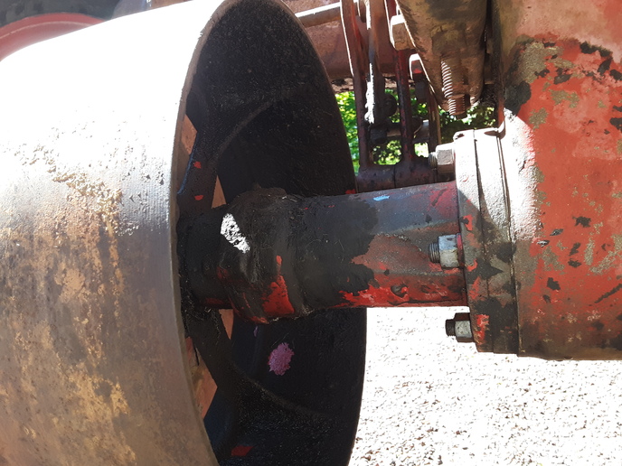

Hey all, I'm working on the rear end of my 1937 F-20, and want to pull the belt pulley. My F-20 is a narrow tread, and there is only about 1-1/4" clearance from the pulley outer edge to the bull gear housing. That doesn't look like enough room to slide the pulley off it's shaft? Is there a clever way to remove this on a narrow? Maybe disassembly of the pulley shaft housing at either the inner or outer flange? That still doesn't look like it would give enough clearance.
Thanks, Evan

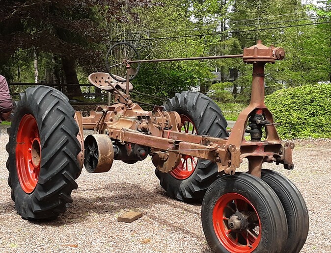

would be nice to see the complete tractor picture. i hate bits and pieces of pictures. just like when people advertize a tractor for sale
with bits and pieces. why cant they operate a camera and put the whole unit in one photo, instead of 6 or 8 pictures. as i tell them i can zoom
in on what i want to see. some tractors you had to remove the tire. but here it looks like a drop box in the way not bull the bull gear.
Untitled URL Link

Well, I thought I'd just show photos highlighting the problem, but here's a pix of the tractor as it is now. I've noticed the standard width F20's have a lot more room to move that pulley out. And, yeah, I know the rears are on backwards.

Even on the standard rear F-20, the pulley wont just come off the shaft. The whole assembly comes off the transmission.
I have a standard width F-20, but Ive heard on the narrows, you have to take the bull gear housing off the right side.
I wonder if a stud remover socket could pull the studs and let you get the assembly out? I dont know why they didnt just use bolts to hold them on.

Yeah, 3L, it seems crazy that it isn't more easily removable. Not a bad idea to remove the studs, but even then there doesn't appear to be enough room to decouple the outer pulley shaft from the inner shaft without running into the housing. At least that's the way it looks in my manual. Thanks, Evan.

Take nuts off and remove as a unit you will have just enough room.
once the unit is loose you will need a pan under it to catch the gear oil coming out, it is the lowest point on the tranny.

No,you dont need to remove the final drop box. when I installed the belt pulley on my F20 narrow,there was just enough wiggle room to let it slip on. I suspect
it will be the same comming off.

Follow up. Got around to removing the pulley. As DeltaSteve suspected, by unbolting the four studs mounting the pulley tube to the transmission housing there was just enough room to slip the tube off the studs and drop the assembly. Maybe 1/8" between the pulley outer edge and the drop box side. Thanks, Evan
