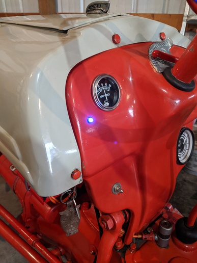

Im not aware of indicator lights on any N that I have seen.

9Ns had an 'ignition on' indicator light. Google wiring diagrams by JMOR'.

CVPost-Tony in SD wrote:
(quoted from post at 15:54:46 05/08/21) Im not aware of indicator lights on any N that I have seen.
A little reminder that the key is on can't hurt!

PostPosted: Sun May 09, 2021 9:22 am    Post subject: Re: Indicator light Reply to specific post Reply with quote
personally, if I wanted to add a reminder that the key was on, I would use a buzzer hooked to an oil pressure switch....

PostPosted: Sun May 09, 2021 10:37 am    Post subject: Re: Indicator light Reply to specific post Reply with quote
Smokeonthewater wrote:
(quoted from post at 10:22:39 05/09/21) personally, if I wanted to add a reminder that the key was on, I would use a buzzer hooked to an oil pressure switch....
I try to live by the KISS principle. This light is simply on if the ignition circuit has voltage. Now a buzzer for low oil pressure?... That has possibilities!

PostPosted: Sun May 09, 2021 10:52 am    Post subject: Re: Indicator light Reply to specific post Reply with quote
Btzj02 wrote:
(quoted from post at 14:37:27 05/09/21)
Fairly common on marine engines... generally tied into temp switch too
Buzzer serves the same purpose as the light plus an oil warning....
If you like the light and want an oil warning, simply ground the light through an oil pressure switch.... then it would go off when the engine started as long as oil pressure came up

PostPosted: Mon May 10, 2021 3:05 pm    Post subject: Re: Indicator light Reply to specific post Reply with quote
I had an extra hole in the dash and did the same thing with a green LED.

PostPosted: Sat May 15, 2021 5:49 am    Post subject: Re: Indicator light Reply to specific post Reply with quote
Yes, Tony, they did. The first 25000 units or so had a dash Ignition 'ON' lamp -see pic. It was mounted underneath the AMMETER and used a standard #63 bayonet-style 6V bulb, the same as the TAURUS and DUOLAMP Taillights.
EARLY FORD-FERGUSON 9N w/DASH LAMP:

PostPosted: Sat May 15, 2021 5:53 am    Post subject: Re: Indicator light Reply to specific post Reply with quote
What wiring are you looking for? All the MPC's have parts and sketches. If you have a 9N dash lamp, you would also have a special wiring harness as well as pushbutton starter mounted on the upper LH dash panel. Need help, email me.
