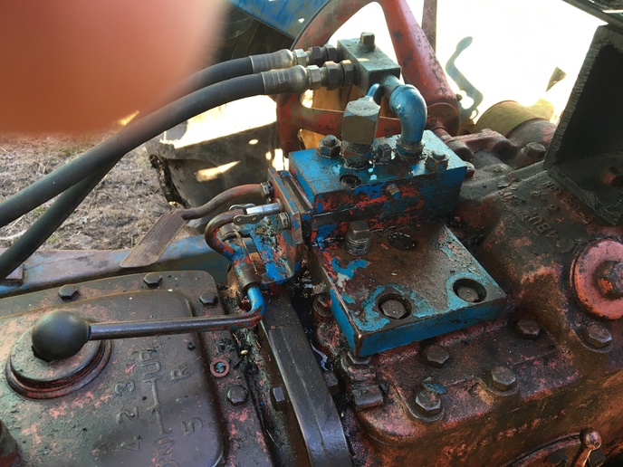

I have a 1958? Ford 860 with a front end loader. the loader works but the three point doesn't. I have included some pictures of the plate where the lift lever is mounted on top of the transmission. in the one picture you can see a extra 3/4 inch pipe plug if I hook a hydraulic pressure line to it will my three point hitch work?

Does the remote valve operate the loader up and down along with the loader having a trip bucket?
With the remote in neutral fluid is directed to the lift control, since the loader works the pump is working but it looks like you have issues with the lift top.
Stuck control valve, cam pin issue, ect
You'll have to pull the lift top to find the issue.

Make sure the lift arms are down a couple inches from extreme top. The three point control lever has to be down some what for the loader valve to
function. Drop me an email, it should be open.

The loader works fine the bucket dumps manually there are no cylinders for the bucket but the three point doesn't do anything.

Are the lift cylinders for the loader single acting?
Did the 3 point ever work since you've had the loader installed?

I don't have an answer, just a question. Why are there 2 hoses attached to what looks to be the pressure outlet of the block?

Yes the cylinders are single acting. When I bought the tractor the loader was already mounted on it and the three point has never worked. There are two hoses because one goes to each cylinder of the loader.

I've never seen a remote valve quite like that one. I am guessing it is some third party valve that was installed with the loader and it somehow bypasses the 3 point lift circuit and dumps the fluid back in the sump, and that the owner at the time that the loader was installed didn't care bout the 3 point lift. There might be some way to reconfigure that valve to allow the 3 point lift to work, but if you have no documentation for it you would need to rely on someone on here recognizing it and knowing how to configure it.
If no one can identify it and tell you how to reconfigure it, I would recommend replacing that valve with a proper Ford or Tisco remote valve that can be configured for single acting cylinders and also allows the 3 point lift to work.

That is a Ford remote valve, my 62 model 801 had one
It is plumbed for single action control with that small line running from the second port back to a the block
It works the same as any other Ford remote has it gets fluid from the pump first and then directs it to the lift controls
Since the loader works the lift issue is in the lift itself, most likely the lift control valve is stuck but Id go thru the lift while its off

Ok so you use that lever to work the loader. Where does the fluid return to?
I always thought the fluid went there first and then to the 3 point. Do you have the original plate that mounts there? I wonder if removing that valve and installing the original plate might allow the 3 point to work? It would be easier than pulling the top cover.

That valve was designed by Ford for the NAA with the right adaptor plate, I would be very interested in swapping that valve for a valve designed for
your 860.My email should be open

I might add that you will probably have to remove the lift chest to free up the unloading valve to get the three point working. Don't think the remote valve is your problem

In a loader with single acting cylinders, it only has power to raise the arms and it relies on gravity to lower them. When the control valve is properly configured for single acting cylinders, the fluid flows back through the same lines that deliver the lifting power when the control handle is moved to the lowering position and gravity does its thing.

The fluid returns back thru the valve the same as any other valve with a single acting cylinder hooked to it
His loader only has hoses connected to the lift side and has not down pressure
Implements such as a wheel disc, trailed brush hog, 3 point disc mower, Vee rake with one line connected to the lift cylinder all work in the same manner and would connect to the valve the same as how his loader is plumbed
Anytime your not operating the valve fluid is being directed to the 3 point lift controls

So back to the original question what is the extra 3/4 inch pipe plug for?
