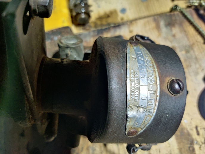

wore out wrote:
(quoted from post at 10:43:55 05/15/21)
I wonder what the tag on the distributor says? Looks like a Delco or possibly an Autolite tag.
Delco made conversion distributors for many engines/tractors that were sold as aftermarket accessories/updates.
Autolite probably did, as well.
If it IS a Delco, it's wildly POSSIBLE that it would use the same crossed helical gearset as they used in their upright distributor conversions such as the one pictured on an IH engine in the photo below.
If that would happen to be true those Delcos are a LOT easier to find and gears could be swapped over to the Ford version.

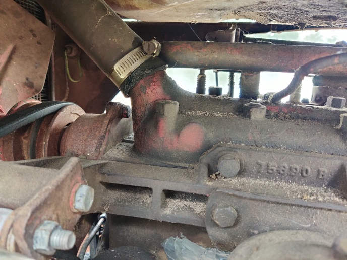

It's likely an engine swap out of a gen set or pump. Does it have a GP-6050 stamped on top of head and two holes up by the neck?

<a href=https://imgur.com/BJfGsdv><img src=https://i.imgur.com/BJfGsdvl.jpg title=source: imgur.com /></a>
Does not have the holes.

Looks like it is a. Autolite.

What you have looks very much like my angle drive with Wico Magneto from a Gen Set with N tractor engine. Mine does not have the oiling scheme like yours. I replaced the Wico Mag with a Autolite distributor much like yours except mine is from a Jeep. A front mount distributor should bolt right on no problem. You may need idler pulley to keep belt away from distributor wires.
I can find parts list and numbers for Fairbanks Morse angle drive as used on war time tractors but the gears are very different. I can not find parts list for Wico Angle drive. Why do you think your gears failed if your oil line was working?

JMOR, look at the JBWeld block repair photo and the bracket right above #75-890 B that Alt/ Gen and oil filter bolt too. I have never seen a bracket like that.

(quoted from post at 19:59:38 05/16/21) JMOR, look at the JBWeld block repair photo and the bracket right above #75-890 B that Alt/ Gen and oil filter bolt too. I have never seen a bracket like that.
Neither have I. Different.
