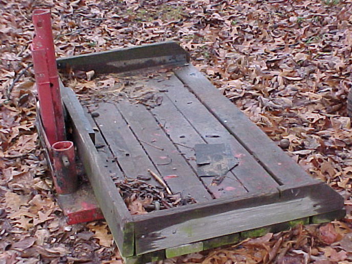

my splitter runs off a 8hp B&S engine, its setup on a small trailer type frame
so you have the tractor free to move wood around and (3 pt hitch lift) do whatever with the tractor.
