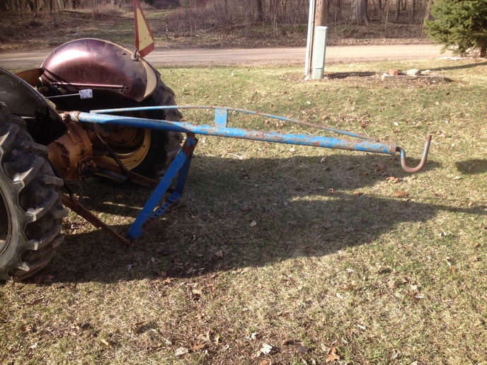

I"ve seen a couple of different styles of boom poles, for lifting. One mounts just like any other 3 pt implement, using the top link. The other mounts "solid" in place of the top link, like a post hole digger, creating a pivot point rather than just vertical motion from the 3 pt. My question, which is better, or more "ideal" if you would?

id go for the one that mounts directly , the end of that one is probably closer to the tractor than the other, you want to stay as close as possible to the tractor with the pole end with a N as you dont have a lot of front end weight there and the farther out the end of the pole, the less you can lift

I would say the type that hitches up like any other impliment as you can adjust the height of it with the top link.

I built this one years ago and it has always worked well for me. strong enough that I can easily pull the front of the tractor off the ground if the pickup load is too heavy.
!!!!!you must have some adjustment!!!!!!!
sometimes you will want the end of the boom pole higher or lower either at the start of the lift or the top of the lift.
with one like mine, you just lengthen or shorten the top link arm. it makes an easy higher/lower adjustment to the end of the boom pole.
on a boom pole that the pole connects to the top link of the tractor, to make height adjustments you have to move the lift arm bracket adjustment under the lift pole. much like the the lift adjustment on my Post hole digger.
However it works too, so go with the one you get the best deal on.

Go with the normal mount. By adjusting the third link you can change it a lot. I can have the top of the boom almost touch the ground with it turned out and the tip about 6 feet off the ground with it turned in. The adjustment really helps when you can't lift something quite high enough - you have a way to adjust.

I have the adjustable boom pole and even though I haven't used the non-adjustable I prefer what I have. I can adjust the top link for differant lifting needs. Should I ever tap my hydraulic FEL system I can install a hyd. top link for expanded lifting capacities and uses.

My non-adjustable pole lifts from 2' to 8'. I like it, but since I've never used the adjustable one I really can't compare.

Very cool paint job Scout!!!
I can't get my head around this. . . .
If you lengthen the top link it allows the boom to go down closer to the load with a shorter chain, but then the end of the boom doesn't lift as high as it would have with a shortened top link. (?)
It seems like six of one and half a dozen of the other . . . there's something I'm not grasping here. Shocked
