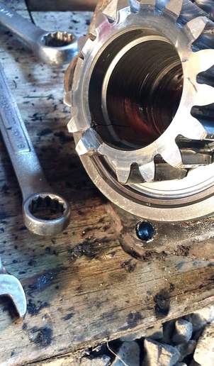

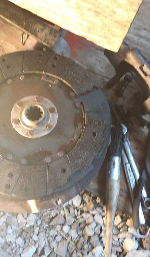

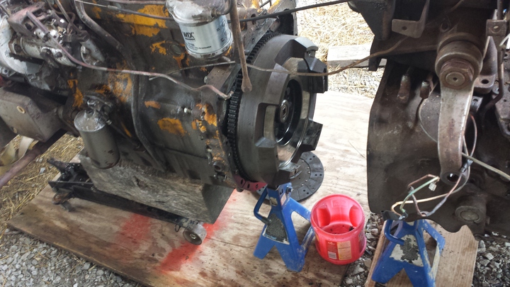

I split the tractor and the drive clutch was bad. also several other things. I will try to post pics soon. split the trans off the rear end and pulled top cover. post back tomorrow

parts list so far for repair; pto input shaft, pto gear, countershaft, rear main seal, lift cover gasket, clutch, pressure plate, throw out bearing, pilot bearing. Should get me back in business. Kind of surprised how many views this thread has. Stay tuned. More pics and progress to come.

The PTO gear i ordered had the correct tooth count but the incorrect spline count. I have that reordered and on the way. Since I have the transmission apart I am ordering new multipower clutch packs. When all the parts come in I will reassemble the trans and post pics as i go. The final step in assembly will be to install a new rear main, clutch, pressure plate and throw out bearing before rejoining the tractor split. Stay tuned for pics and progress!!

New PTO gear is here and it's the correct one. I wish I could go direct to Sparex, Inc.
I need to order a couple seals and some other parts before assembling the pto shaft. Stay tuned.....more parts, lol.

Good pictures, nice to see it come back together Smile
With the broken parts list you posted it seems the earlier "rebuilt" done to it wasn't much proper at all.

New Rear Main Installed
