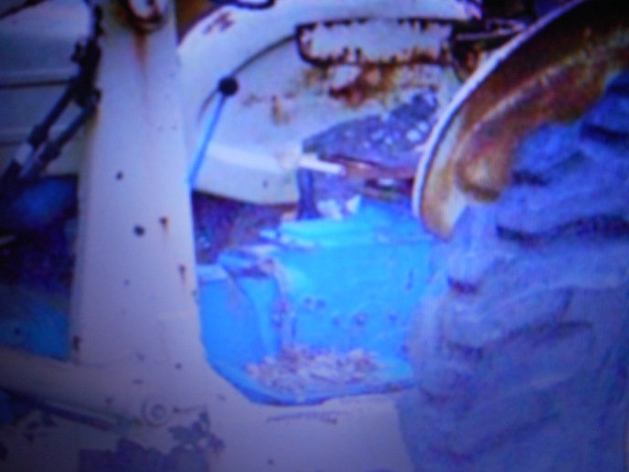

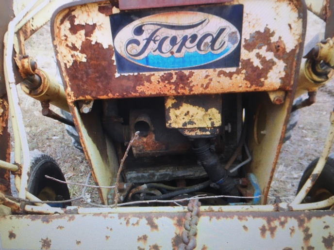

PostPosted: Thu Mar 07, 2019 11:31 am    Post subject: Re: ford tractors Reply to specific post Reply with quote
Are there any # locations that positively identify it as a 4500 ford or not. I noticed that the 3550 has the same heavy front end , flat plate at top in front of radiator ?

PostPosted: Thu Mar 07, 2019 12:11 pm    Post subject: Re: ford tractors Reply to specific post Reply with quote
Look on the bell housing - just above
and behind the starter.
See photo.
There should be 3 lines of code hand
stamped into the flat spot there.
You may have to clean/scrape/brush or
chaulk to read them.
Post those and someone here can decipher
them for you.
As for whether it's a 3550 or 4500;
Yes they used the same bolster but the
power steering was different.
A 4500 and 4400 had the PS cylinder in
the bolster under the radiator.
A 3500 and 3550 had external power
assist.
Look at the heavy steering arm attached
to the left side of the front axle on
the yellow tractor.
And look at the side arm steering
cylinder on the blue tractor.
Together that is the configuration a
3500 and 3550 had.

PostPosted: Thu Mar 07, 2019 12:16 pm    Post subject: Re: ford tractors Reply to specific post Reply with quote
3550 production didn't begin until 72, your tractor is a 69.
Looking at your photo!
4500 has that oil tank made into the shell, parts look up shows a 3500 doesn't have the oil tank
4500 air cleaner access plate is on the left, 3500's is on the right.
I see power steering lines going down to the cylinder in the front bolster.
4500 uses this type of steering, 3500 does not.
There's another set of numbers in the same location as the ones you found, may be farther back in the unmachined area.
The model numbers for my 4500 are D5011K
D50 = 4500
1 = diesel engine
1= no pto
K = 6x4 manual reversing trans
Your's should have the same D50
Your looks to be diesel so should have the 1
Don't see a pto lever on the left side under the seat so another 1
D5011?
The last letter depends on the tractors trans option.

PostPosted: Thu Mar 07, 2019 2:52 pm    Post subject: Re: ford tractors Reply to specific post Reply with quote
Mine is D5011K also. No PTO either.
