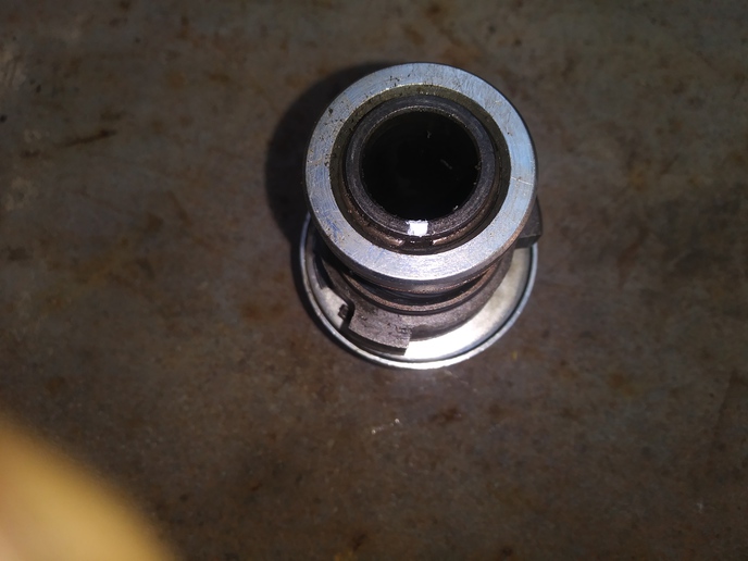

Hobo I'm trying to disassemble a starter drive I can't get to retract, for the life of me I can't see the C clip. Any help will be appreciated Eric

You can see the ends of it near the white dot.
