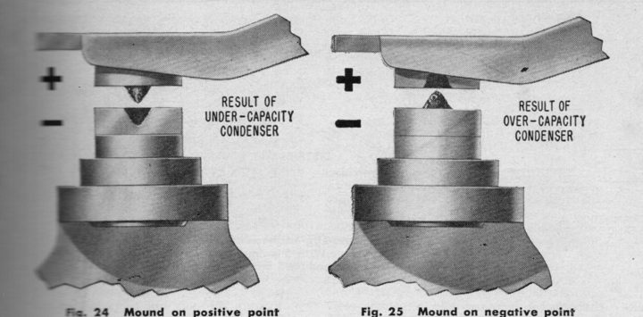

The "voltage withstand" rating of a condenser used in EITHER a 6 or 12 volt system is MUCH higher then 6 or 12 volts anyway, so subject to the coil YES a proper rated condenser can be used in EITHER a 6 or 12 volt system. Its the capacitance that's critical more then if in a 6 or 12 volt tractor. The condenser capacitance is sized to work with the inductance of the coil, so subject to the coils inductance the same size condenser might be the same in either a 6 or 12 volt system.
If there's no condenser at all the coil can still fire but the points will burn up prematutely,,,,,,,,,,If the condenser is too large there may not even be a spark,,,,,,,,,,,,If the condenser isn't sized properly there may be a build up on one of the points surfaces.

Regardless of RPM when the points are closed the cap is setting there discharged and theres x joules of energy stored in the coil/inductor. Then when the points break open some current flows into the cap and it charges up and stores x energy but when they go back closed that energy gets discharged back through the closing points in the other direction. If each charge and discharge the energy flow through the points is the same it wont build a pit on one side and mound on the other side SO IT LOOKS TO ME LIKE ITS THE CAPS CAPACITANCE AND THE COILS INDUCTANCE THAT NEEDS TO BE BALANCED/MATCHED and that's true regardless of frequency BUT NO WARRANTY ON THAT AT ALL.
NO I don't see inductance and capacitance labeled on coils and condensors but that sure dont mean they aren't rated and arent engineered to work in certain applications and again YES the condenser is rated to work with certain inductance coils. If the wrong values are used points go bad prematurely and can pit or mound as Johns picture shows
