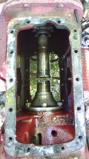

I just picked up a beautiful 53 Jubilee with a loader for cheap, however it won't move. Runs great, seems to be able to find all the gears, and PTO turns as it should. The guy I got it from said he was using it and heard a "ping" from the rearend and it just quit moving. I was originally gonna use it for parts, but would rather try to fix it if possible. Anyone have any ideas as to what the issue could be and if it's worth the money or should I just use it as a parts tractor like I originally intended.

Broken axle Remove the rear end fill plug with a flashlight you should be able to see the ring gear if it is turning it would be a good clue.

I agree good chance it has a broken axle. Seen that more then once with a Jubilee with a loader. The axles where a bit on the weak side on them

Pull the side cover off and check the connecting coupler between
the trans and rear to see if that's broken first.

Ahaa! I do believe this is supposed to be in 1 piece! Just need to figure out how to fix it now.

Looks like yoru going to have to split it to repair and it and you will need to find that part to boot

That's why I said pull the side cover first. A lot easier then the
top cover but it's done so split and replace. After replacement
jack up rear and make sure everything operates as it should, if ok
put your top cover back on and you'll be good to go.

Thanks for the feedback. It was easier to pull the top plate like I did because of the loader assembly he has mounted to the tractor. No difference now, it all has to come apart. Last question... Is this considered an actual driveshaft? Been looking through the manual, and it appears the only reference I see to it just calls it a coupling. Guess it's just curiosity.

So, this is what we came up with as a fix for the broken coupling. May have slightly over engineered it, however no tractor splitting was involved and it runs like a champ!!
