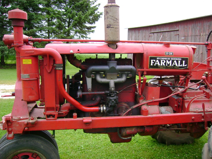

I've just put the top end of the f20 back together and it runs beautifully. Starts with a half crank, idles great, and revs smoothly.
My question is with the throttle linkage. My f20 is a 38' and has the throttle linkage on the left side of the gas tank. I'd say there are roughly 10 notches in the linkage bar for throttle adjustment. The first notch (closest to the handle) is idle speed and each notch down the shaft would be more throttle then the last, I get that much but this is how mine works, first notch idle, second notch wide open throttle.
There is a little slop and play in the crossover linkage from the left side throttle bar to the govener rod, but not excessive. I've tried adjusting the govener linkage rod but really the only thing that does is move the notches I use on the throttle linkage up and down. One is still idle speed and the next is wide open throttle.
Is there any way to adjust the govener itself so that such small movements in the throttle linkage don't make such big changes in engine speed?

The F-20 used two throttle linkage that I know of. The color photo is my F 20 with factory linkage and throttle is on left side of tractor. The black and white photo is the up graded linkage with throttle on right side of tractor.

PostPosted: Sun Jul 23, 2017 6:49 am    Post subject: Re: F20 throttle linkage Reply to specific post Reply with quote
Mine matches the red tractor.

PostPosted: Sun Jul 23, 2017 9:10 pm    Post subject: Re: F20 throttle linkage Reply to specific post Reply with quote
All F20's through the 36 model year came from the factory with a fixed speed governor. The throttle lever on the steering post was there to idle the tractor. On these tractors the governor only functioned in the full throttle position as the throttle lever went to the front of the hood and then down to left of the engine and moved the end of the governor linkage attached to the carb. These tractors were unable to govern lower engine speeds. The fixed speed could be adjusted for belt work/ belt speed by turning the spring housing on the backside of the governor The 37 models came with a variable speed governor and the throttle lever was then moved to the left side of the tank and had the cross over bracket on the front fuel tank support.Only the spark lever remained on the steering post. These tractors governed the engine at all selected speeds. IH also introduced a variable speed field upgrade for the older tractors at this time. The IH upgrade is identified by the addition of a cast pivot arm on the governor top plate. Sears and Many others also sold update kits for these tractors and Heisler sold a kit with a throttle like an M. By the way the lower picture that D Beatty posted is MY 36 F30 with an aftermarket variable speed kit.

PostPosted: Fri Jul 28, 2017 6:19 pm    Post subject: Re: F20 throttle linkage Reply to specific post Reply with quote
I got her all figured out. A little time and tinkering and good as new and works like it should now. The linkage was way out of wack. I still never could find the literature for the setup procedure on the governor but they all pretty much operate the same way. I adjusted it just like I would a Briggs and Stratton and worked like a charm.
