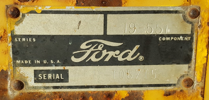

It should have a tag on it something like this.

PostPosted: Tue Oct 10, 2017 4:42 am    Post subject: Re: backhoe Reply to specific post Reply with quote
According to the parts site, 19-551 is listed as "BACKHOE, BASIC 15" 755 SERIES (1/69-12/80)"

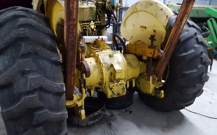

Sean in PA wrote:
(quoted from post at 05:42:16 10/10/17) According to the parts site, 19-551 is listed as "BACKHOE, BASIC 15" 755 SERIES (1/69-12/80)"
My 1971 Ford 4500 with 755 series BH
