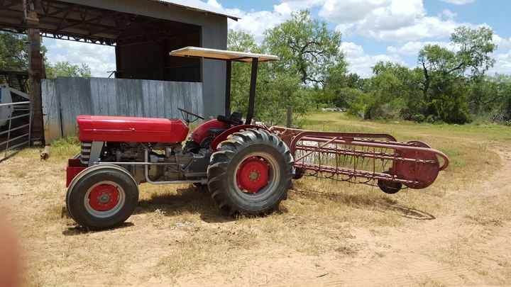

I even do the same thing when its 90 + degrees with enamel paint. Also if you are going to respray it use gloss hardener in the paint, the shine will last a whole lot longer, and its less likely to be scratched.
My MF135 I painted using the gloss hardener, and the quick last spray with the thinner only.
