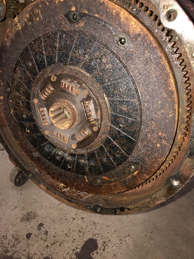

My took my 2N out for a Fall drive around the block (about 1.5 miles) performed great, as it has in the past. Parked it in its stall (enclosed dry unheated barn). Returned the next
day to move it again.....started fine like always. Would not go into gear (any). Adjusted clutch and still would not go into gear. Restored linkage to original position and still not able
to get into gear. Any ideas what is going on? Did not try to pull tractor....and if I do is this the way to free a stuck clutch?
Also there is no port or opening in the clutch housing like the later models. I am stumped?

It's actually fairly common for the clutch disk to stick if the clutch
pedal is not blocked down. If it hasn't set for very long, blocking
it down and towing it around while hitting the breaks may free it.
The only fix for this one was to split the tractor and replace it.

What Royse said.........
And, once they stick, they will stick again.
Block the clutch.

You said would not go into gear. Would it not let you move the shifter into gear or when you move the shifter it would grind not letting you move it into gear?

Ditto what the others said. Adjust free play correctly.. then block it for a couple days.
Post back.

Back in town........OK...thanks but what do you mean "Block" the clutch?

Press the clutch pedal down, then block it. That way spring pressure stays on the stuck parts. Many times they just pop free after a while.

Like this!
