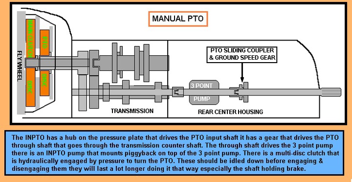

On the pto does the tractor have 3 point, if it does you need to find out if it has a dual, or split torque clutch.
If it has a 3 point with a dual clutch adding pto to it would be just a matter of getting the pto parts.

PostPosted: Sun Nov 26, 2017 11:20 am    Post subject: Re: 202 work bull questions Reply to specific post Reply with quote
Not that is matters but it does have a plate over where the PTO shaft should be so there is a chance it has what is needed to just put in a PTO but have not look to make sure it is that easy. As for the control valve I have a good one I picked up at a yard sale a few years back so may try that also

PostPosted: Sat Dec 02, 2017 6:26 pm    Post subject: Re: 202 work bull questions Reply to specific post Reply with quote
This is a typical MF pto setup.

PostPosted: Tue Dec 05, 2017 1:38 pm    Post subject: Re: 202 work bull questions Reply to specific post Reply with quote
You can take everything you need for the PTO from a TO35, including the 3pt lift and pump if desired.
