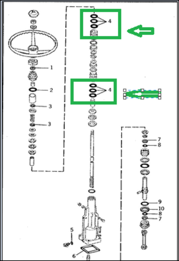

Jim, where did you get the image of the valve you mentioned with the plug. I can't find one like that on JDparts. None of the sectional drawings seem to match my loader. They all look like closed center. Perhaps someone replaced the valve? Your image looks right, but I need part numbers.
The image below is the closest one I found but the plug looks wrong.
I'm going to replace the supply lines first, because if the pump is not getting enough oil flow there is no point in checking anything else.
On the steering, I pulled everything apart, completely stripped it down. I replaced one shim that was worn with one off the the spare steering valve. No signs of wear otherwise. The only thing that may be a problem is one of the tiny valves was not operating very well. I cleaned it and would guess it was at 90% when I put it back in. That was the upper valve. I would have just swapped the valve but the other spare one was much worse. I should have seen a major improvement after the rebuild, even if the new valve was not 100%.

PostPosted: Sat Dec 02, 2017 10:15 am    Post subject: Re: 1020 hydraulic issues Reply to specific post Reply with quote
You can find schematic for convertible(OC to CC & vice versa) valve in JD parts catalog for model 37,48 & 145 loaders plus probably more catalogs.
On steering if one or more of the 6 large o-rings is leaking it can make hyd's do strange things especially heat up & cause frt pump to cavitate.

Yeah all the orings got switched out, but it could be possible one got out of place when the valve assembly was inserted in the housing. Not exactly easy to get back together.
Just doesn't make sense to me the new (different) valve would have the exact same issue as the old one I removed.
I've had issues for a long time with the steering locking when stepping on the brakes a lot especially when using the bucket, however this new problem of the steering pulling right started not long after the last time we split the tractor. The tractor is also much easier to steer while moving then when stopped. Most of the time I have no power steering to the left, and as soon as you let go of the wheel it pulls all the way right every time.
