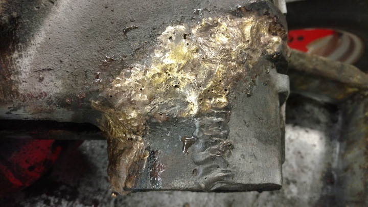

That makes me feel better about just brazing it and getting it over with. I have it apart and cleaned up and Veed out. Might braze it tomorrow but I have to check to make sure I have enough rods. I ground out quite a bit of material as it was a meandering crack. As soon as I figure out how to wring a picture out of the cell phone I will post a pic for the approval of the welding/brazing experts.

PostPosted: Tue Dec 05, 2017 4:10 pm    Post subject: Re: Wide front casting SC Reply to specific post Reply with quote
fixerupper wrote:
(quoted from post at 17:03:01 12/05/17)
CVPost-Case Nutty 1660 wrote:
(quoted from post at 15:00:54 12/05/17) I have three Sc's with wide front,, and had another one that lived its life with loader on it,, none have broken,, my DC also has a WF and has lived its life on a loader as well, betting it is more abuse than a design flaw
cnt
OK, here's a pic or two

PostPosted: Tue Dec 05, 2017 4:19 pm    Post subject: Re: Wide front casting SC Reply to specific post Reply with quote
fixerupper wrote:
(quoted from post at 17:10:01 12/05/17)
cnt
Here's the crack ground out. The depth doesn't show up in the picture but it's about 3/8" deep. The casting is 1/2" thick. The other fix is welding and is holding but it isn't Veed out very far, maybe 1/8". I got a little carried away and off course with the grinding.

If I was to repair this, after welding/ brazing I would grind the welds down to the original then make a ring of 3/8 or 1/2 steel with an ID to match the OD of the repaired casting to encircle as much the lower part of the casting as possible then weld that around. Then that would fix it for once and for all.

You'll have to get the v-notch over the crack better than you have it. Are you sure the previous repair is a arc weld. Looks like a brazing job to me. Do remember to drill a 1/8" hole at the very end of the crack. Otherwise the crack will continue beyond where you will be heading it. Maybe you better get larger than 1/8" brazing rod and a can of flux. You have quite a large area to fill in. Keep us posted on your progress.

Ya, I ground it out pretty wide. Wasn't paying close enough attention to where the crack went. I did some grinding on the previous fix and it was silver colored instead of bronze. Here's a pic of the inside of the bore.
The straight line crack is the previous crack the diagonal crack is the one I am working on. After looking at this picture the top of the diagonal crack goes along ways around the bore at the top. It doesn't show that much on the outside.

See if you can clean the grease out of the crack. Brake cleaner and a wire brush should help. The flux on the brazing rod should keep any left over grease out of the bronze.

One more thing to add. If you do decide to file the bronze to smooth it out before painting, you should chalk your file before you use the file. Chalking a file involves working chalk into the grooves of the file. It keeps the bronze material from packing into the bottom of the grooves making it impossible to clean the file with a file card. Don't fill the grooves completely with chalk, just file the piece of chalk you use lightly so the bottom of the grooves have some chalk in it. Clean the file often, and apply more chalk as you're filing your repair. Just a little something I learned in the course of watch repair.

PostPosted: Wed Dec 06, 2017 12:53 pm    Post subject: Well, here it is Reply to specific post Reply with quote
Here's the brazing job. Craters of the moon.
