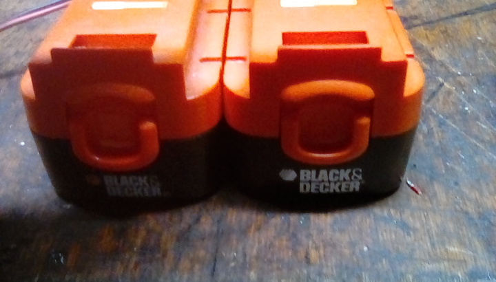

I have a black and Decker HPD1402 cordless drill. The batteries need to be replaced. Some of the replacement batteries are 1500mAh and some are 2000mAh. I do not see anything on the old battery, as to which of these ratings that I should buy. Is the 2000mAh the better battery?

Are they the same physical size? if they are then I would use the 2000 mah. they will take a little longer to charge and last longer in use.

Bigger is better. The higher the number, the longer it will run on a charge.
The only draw back could be the weight. The higher capacity batteries are a little heavier, possibly a consideration if doing prolonged or over head work.
