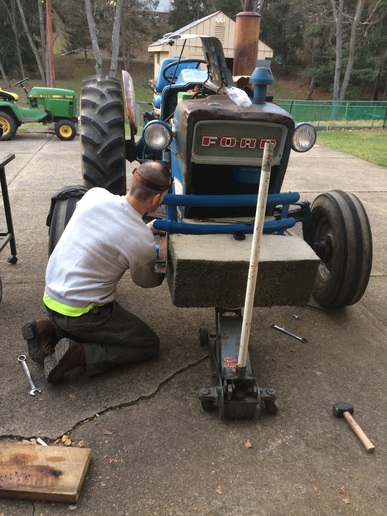

I built a counter weight for the front of the 4000 SU. It was cheap and easy. Once I mounted it and gave it a test run. I took it off and cleaned the metal up and painted it. Will mount again in the spring.
I fixed the fuel leak and an oil leak but still need to do the pto seal.

What are you hanging off the back that you need so much on the front?

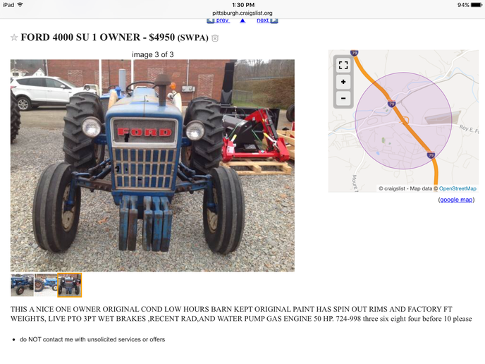

the one I inquired about had 24" tires I believe - cast centers, no spin-out rims, looks like the 24" combos that I have on the 4500 - here's another one with the same centers/rims
https://centralmich.craigslist.org/grd/d/ford-4000-su-special-utility/6377755078.html
the one I missed was similar, about the same price, had good ag tires, and was quite a bit closer to me -
if I'd had a good year I might have popped for this one even with the turf tires, but there's not much spare change to play tractor this year

It's been a little trial and error. Things are a bit hilly around me, so everything from the 6ft tiller to my untility box makes the front light on the hills.
I first tried just 80 lbs concrete behind the bumper. The bigger block is about 180 lbs. I think I might remove the 80 lbs but not sure yet.
It not uncommon to see a set up like this around here. I was looking to do a weight bracket but it was just to pricey.

Ag tires will hit you for $12-1500 mounted for that tractor so that's getting the total cost up a little high for a gas model here, but gas models may be worth more up north in your area.
Most any 4000SU seen around here had 14.9-28 rears but they also came with 16.9-24's, I think the 28" rims where more popular. Although it was a odd wheel center back then it's the same type wheels as used on later model 3910, 3930 tractors, so used tires and wheels is a option from a salvage yard.
I think Tractor Data go it wrong again saying 7.50-16 was the front tire size. That's the correct size for my 4000 but all SU's I've seen had lower profile 7.5L15 fronts or the narrower 6.50-16.
