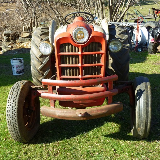

Glad to hear the positives! I got mine 8 days ago, I took a gamble on one that had an almost non functioning SOS. I got it home and just let it sit there running, it had been sitting for some 10 years, and after a while it started working! After 15 minutes of driving it around every gear worked. Then when I tried it yesterday it was back to not working, but again, started working after getting limbered up. I guess I'll start by changing the trans oil. Here it is:

Nice looking tractor, power steering, hydraulic remote, good looking tin.
Looks to be in about the same condition as mine, original paint with patina.
As other's told me when I first got mine, DON'T PAINT IT, very few original paint tractors still around in good condition, had a lot of folk looking and complimenting about mine when I took it to a show, they all said to leave it original.
Mine had been setting in a barn for over twenty years, we checked to fluids before ever firing it up to make sure there wasn't any water in them. I've used it about 20 hours pulling wagon loads of corn and raking hay, haven't changed the oil yet but it's on the todo list along with a new pto seal.
I need to adjust the bands, when it's cold it wants to creep off when you first shift back into park
