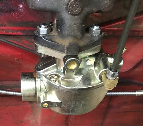

I installed a rebuilt carb (probably made overseas) on a Ford 2N. The engine does not run as smooth as I would like. I cannot get any change in the engine when turning the adjustment screw on the side of the carb. Any suggestions would be appreciated.

I think you answered your own question:
" I installed a rebuilt carb (probably made overseas)"
If the adjustment screw does not change anything, you have a problem in the carb. While it could be dirt, it could also be a manufacturing defect.
Buying a clone carb is a lot like buying a Lottery Ticket.
Lots of good advice in the archives about carb rebuilds; the best one is authored by Gary & JMOR.

CVPost-Randy K. Crump wrote:
(quoted from post at 09:30:40 12/05/17) I installed a rebuilt carb (probably made overseas) on a Ford 2N. The engine does not run as smooth as I would like. I cannot get any change in the engine when turning the adjustment screw on the side of the carb. Any suggestions would be appreciated.
There may be nothing wrong with it. If it is the M/S or one of the M/S clones, then I assume you are turning the idle mixture adjustment screw. If so, then it will do nothing unless the engine speed is very slow. Just a little fast, and the carb is operating off of the idle circuit & on the main power circuit. If 'not running as smooth as you like' means at speed, then the idle adjust is not going to change that.

Randy........1st things first; change yer sparkies. (really) All that carbie tweek'ems has FLOODED them. Recommend AutoLite 437's gapped 0.025. Don't throw yer old sparkies away, just clean'n'dry 'em one-atta-time in HOT running engine. 2nd thing, check yer sparkie wires. Shuld be limp as a wet noodle. Must be COPPER CORE, not modern carbon string sparkie wire. NOW we kenn talk about yer carbie. ALL carbies haffta be adjusted, even brandy NEW ones. Check float level 1/4". Summ times they cumm off'n their hinges during shipping. Now fer the tweek'ums. Set the down-pointing MAINJET to 2-turns and LEAVITT!!! Adjust the side-pointing IDLEMIX fer FASTEST idle; NOT SMOOTHEST idle. Understand the difference? Shuld be about 1/8-1/4 turn. Unlike the 8N's, yer 2N does NOT have a tacho. Go to an auto parts store and gitt an el-cheapo fer a rice-rocket and runner off'n 9-volt battery. After ya gottchur FASTEST idle, 1/8-turn atta time, adjust the BEHIND the carbie idle SPEED fer ennythang under 500-rpms. I once gott my easy starting 6-volt 52-8N to idle at 375-rpms with a transistorized tacho. It kenn bee dunn. Pay attention to what Bruce and JMOR said.......Dell, yer self-appointed sparkie-meister and carbie-meister

My first thought was exactly what JMOR posted.
Side of the carb is the idle air adjustment.
Keep in mind that it adjusts air. Turning it in causes a richer
mixture at idle, turning it out is a leaner mixture.
There is a a proper adjustment procedure in the I&T FO-4 manual.
As an aside, if your new carb is one of the new Tisco/TSC gold
colored carbs like this one, the normal rebuild kits don't fit either.

I removed the spark plugs (Champion H10C) and installed AutoLite 437. The plugs were all black. The engine has been overhauled. I will work on the carb as you suggested when it gets a little warmer outside. My portable Tach has two wires. Were do I connect them on the engine? Maybe I should remove the carb and check the float level.THANKS
