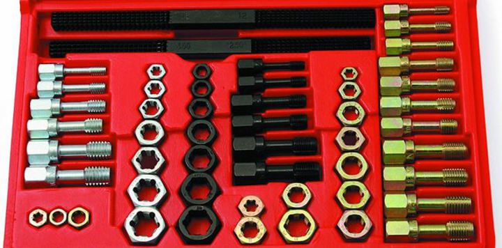

I recently did a hydraulic repair on my 8N, which may never have had its hydraulic case opened since being manufactured 1949. When disassembling it, the bolts, nuts and studs came off very hard, so I decided to chase all the threads with a tap and die. I couldn't believe how much crud came off of those threads. I had to chase them 2 or 3 times to get them clean. This was by far the most time-consuming part of the repair. By the time you've chased all the threads and received your replacement parts in the mail, you forget how it all goes back together.
I have read many times that OEM Ford threads were much tighter than today's standards.
Safest to use a thread chaser as it will not cut new threads like a tap or die will.
